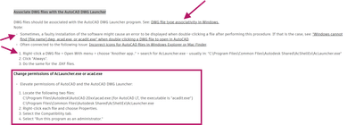

I think you talking about the case you dblclick a .dwg/.dxf file in Win Explorer.
If so, and if you can open multiple drawings by using OPEN command in AutoCAD,
it isn't a SDI thing.
The problem is: Your .dwg/.dxf/.dwr extensions are not linked to the aclaunch.exe
If we right, sesrch for ACLAUNCHER and link your Acad files to open with the aclauncher.exe
