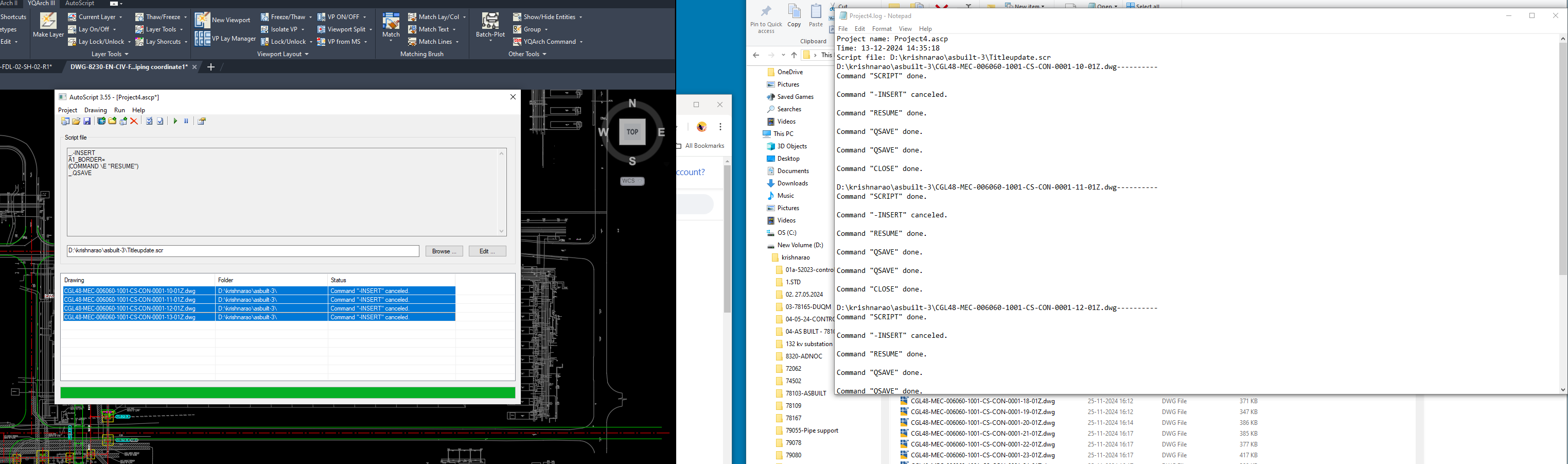

I have installed through local d:Drive. But it doesnot replace my title block as per the script.
it open all the drawings and close each. But does not replace. I have the same block(a1_border) in my all cad files
-INSERT
A1_BORDER=
(COMMAND \E "RESUME")
QSAVE
Krishna

krishnandynBQY9Z
I tried autoscript also in the same files, insert title block fails. I don't know why. When doing manually it works.
Please find attached.

paullimapa
Actually log clearly shows each operation completely successfully.
Perhaps you can try changing the script as a test by completing the Insert command instead of cancelling it.
Then ERASE Last object and see if that works.

Benjamin_AldridgeLTXAQ
If you already have a version of your titleblock defined in the drawing, inserting an updated version will not do anything. When I do this manually I have to delete the block and purge it. Maybe, instead of INSERT try REPLACE.
