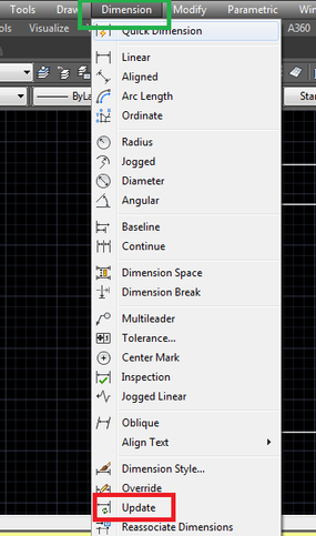

I suggest to use DIMSCALE system variable which you can change and set your scale factor.don't forget after changing the factor to update your dimensions .see attached image
