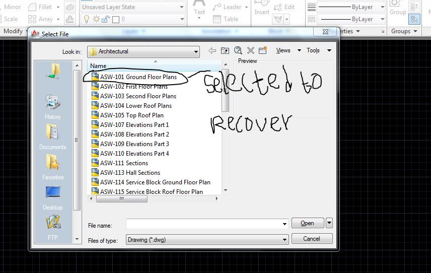

Hello Guys,
I have an error when I trying to save drawings in AutoCAD and you can find the error message with the following attachment. So, actually this error is coming not for every drawings but for some drawings only. I mean the drawings that are making this issue has lot of external references and any of them cannot be deleted, because all those external references are required to complete my drawing. This issue had been promoted before in this forum by some person and few solutions had been given to him. But I tried them all and after that also I am facing the same issue. I even tried to repair as well as re install AutoCAD 2012 and after everything I done I am facing the same issue. Here what I done as solutions.

I am sorry to say that we cannot get the acceptance from management to upload these files due to the client's rule and regulations. But the thing is there is a computer which has Windows 10 with AutoCAD 2012 and those drawings are working perfectly in that and there is a Windows 7 computer which has AutoCAD 2016 and in that also these files are working.
As you said I did _RECOVERALL command and select a file which cause me troubles and It gave me error (probably disk is full) in that procedure also. You can find the procedure in following pictures.
