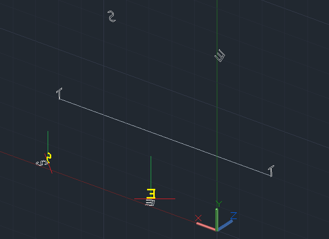

In this picture, I was able to rotate the 'T's in the orientation I want:
Can someone please help me find a way to rotate the 'S' and 'E' 90 degrees in the 3rd dimension as was done with the 'T's?
The text 'TEST' was made with ARCTXT and TXTEXP.

Hi imadhabash,
Thanks for the response! The information you gave me will be very useful for future projects.
I'm actually looking to wrap text around a cylinder, so I'm not sure how I can use FACE with the UCS. Copying and pasting in different UCS orientation gives me the upper white 'S' and 'E' in a position I do not care for.
I need help rotating the text as shown in this picture I made with MSPaint. The yellow text orientation is what I would like to achieve:
The white line would be the diameter of the cylinder. I would like the text to wrap around the cylinder in the orientation shown with the white 'T's and yellow letters.
Any additional help would be much appreciated.

I also found a way to achieve the results I want. I made a LINE from the lower MIDPOINT of the letter 'E' and connected it to the center of the circle. I made a 3D triangle so I have the FACE that I want the letter orientation to match. From here I used ROTATE to get the letter orientation almost exactly how I want:
If anyone would like to share a more efficient way of achieving these letter orientations, I would greatly appreciate it.
