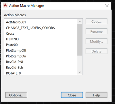

I am circling back to this because I still have this problem with 2020, 2021, and now 2022.
This is what the RMC looks like when I first start Autocad and try to access the Action Recorder to use an existing Macro.
If I click on Manage Action Macros, I see all the macros I have created.
If I then close and access the Action Recorder again, I can now see the Marcos in the list.
When I close ACAD and re-open it, I have to go through this all over again; each and every time.
These are my settings under Options/Files tab.
What am I missing?
