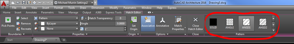

I am in AutoCAD 2016.  I was wondering if it is possible to remove the "Pattern" pane from the Hatch Editor ribbon (pictured in attached screenshot)?  The screenshot shows the area I would like to remove, circled in red.
The reason I would like to remove the Pattern pane is because we have some hatch patterns in our server that are pretty slow, some that are extremely slow, and some that completely freeze AutoCAD.  And the problem is, when you are using a working, totally fine hatch, but this working hatch has a name which is alphabetically next to a problem hatch, and you click on the hatch itself (to edit the hatch in any way), the Hatch Editor (including the "Pattern" pane) automatically loads, and, as in the screenshot, the Pattern pane will attempt to show the hatches which are right next to it as well.  So if your working hatch is alphabetically next to a problem hatch, then trying to edit the working hatch will still end up freezing AutoCAD.

But if there is some way to remove the "Pattern" pane from the Hatch Editor, then I can just instruct everyone to remove that and then set HPDLGMODE to 1 when they do the HATCH command, and AutoCAD will no longer get frozen by hatch patterns we're not even using.
OR, I just thought of this approach - is there a way to edit a hatch without using the Hatch Editor Ribbon at all?  Or a way to completely disable the Hatch Editor Ribbon?
Use right-click right beside the panels and turn off the patterns as shown in the screenshot.
Yes you can as seen below . right click on the ribbon ( Yellow star ) then from Show Panels ( uncheck Pateern option )

Great! Thank you both. This worked (as per both of your posts).

I wanted to update this as it turns out the solutions I marked were not complete solutions.  When I close and re-open AutoCAD, the settings revert back to the way they were.  (That is, the Pattern Panel shows up again).  I also checked and it is not a drawing-specific setting either.
So then I went in to "Customize" my Workspace, but then I ended up completely deleting the Pattern Panel from my AutoCAD program altogether - so it's not available in any Workspace now.  And I guess technically that solves the problem for me, because I don't want the Pattern Panel to show up, but I'd prefer to know how to remove the Pattern Panel without completely deleting it from the program, lol.  Not just for myself, but that way I can instruct or help other people in our company to do the same - and I'd prefer not to completely delete a component from their program.  I'll probably figure out how to get it back at some point and then figure out how to disable the Pattern Panel without completely removing it from the program (unless that's actually impossible to do), and then I'll update this post again.

Unfortunately, the method suggested by Alfred and Imad did not keep the setting changed after closing and re-opening AutoCAD. When I used this method, the Pattern panel would successfully be removed from the Hatch Editor ribbon until I closed AutoCAD, but when I re-opened AutoCAD, the Pattern panel would once again show up in the Hatch Editor ribbon. But fortunately, I figured out a way to keep it removed. This involves editing the CUI (the user interface), which makes changes to your acad.cuix file.
