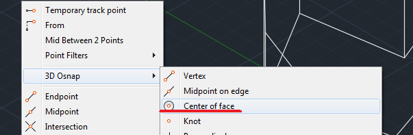

G'day all
Here is an easyone for some free internet points (no pun intended)
hope someone has an answer.
if i get the mass properties of a solid, i get the centroid in x, y and z.
how can i make a point for these coordinates without copy and pasting the coordinates to a text file then making a point and copying the coordinates back into that point?
is there a command say CENTROID or similar where you click the 3d solid and bam, there is your centroid.
this would help immensely for crane lift plans
cheers
Marcus

Ajilal.Vijayan
Another option is to use the 3D Osnap -> center of face
vladimir_michl
You can use the CENTROID "command" (an add-on with command) to draw a COG point - see:
https://www.cadforum.cz/cadforum_en/how-to-draw-a-center-of-gravity-point-tip6820
For some types of 3D objects you can also use the 3D osnap "Center of face".
Vladimir Michl, www.cadstudio.cz - www.cadforum.cz
AutoMarcus
thankyou that worked
