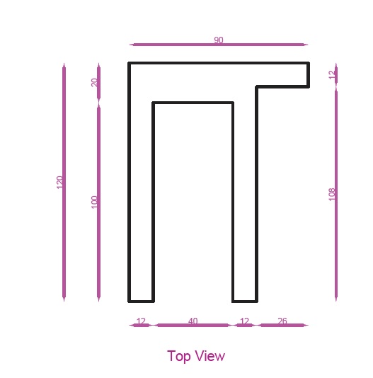

Hello all,
I am facing an issue. When I print my document to PDF. Then it shows the dimensions and lines very thick in the PDF.
how to show my lines in pdf normal.

You need to reduce the lineweight of the color used for dimensions, in the plotstyle editor if you are printing using plotstyle.
If plotting is done with object lineweight, then select the dimensions (or in the dimension style editor) and reduce the lineweight or if you have a specific layer for  dimensions then reduce the lineweight in the layer properties.

I didn't use plotstyle to print.
I use page setup manager in layout1 properties.

Then you can modify the related Dimension Style and change the Lineweight in there
