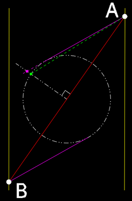

Assuming you mean you want the top face of the diagonal 3x3 to hit the inboard face of the right vertical at that distance from the top, and the bottom face of the diagonal likewise to hit the left vertical that far up from the bottom....
A and B are the ends of your diagonal Line in the image [red here].  With a UCS set in the plane of the overall frame at the red Line, OFFSET the red line by 3" down-rightward [yellow Line].  Draw a CIRCLE centered at A and passing through B [dashed green].  ROTATE the red and yellow Lines, with A as the rotation base point, and using the Reference option.  The Reference direction will be from A to C, which is the INTersection of the yellow Line with the green Circle [not the end of the yellow Line], and the new direction will be to B.  The right side above is after that rotation.  OFFSET either the red or yellow Line by 1 1/2" toward the other, for the center-line path to EXTRUDE or SWEEP your 3x3 along.

Kent1Cooper
@Washingtonn wrote:
Draw a perpendicular line passing through the mid-point of the original line intersecting the circle.
This is the angle for the tubing between the posts. ....
It's not quite clear to me from the description, but if by "This" you mean that the direction from the INTersection-of-perpendicular-Line-with-Circle to the top end of the original diagonal is the angle, that's not correct.  For an exaggerated example, that would be the green here, when what you want is really the magenta:
You can do it by drawing a Circle at the mid-point of the original diagonal, but if that's the approach, then skip the perpendicular Line, and instead draw one of the magenta Lines, from the original endpoints [A & B here], TANgent to that Circle, to get the correct direction for the diagonal tube.  Move that to the center-of-Circle/midpoint-of-original-diagonal, and Extend/Lengthen it as needed for the mid-line path to Extrude/Sweep along.

Kent1Cooper
@Luke_Y.AGII wrote:
this would result in a width or height of larger than 3". You dont need a circle at all, just a line that is 1.5 inches on either side of the connecting line that is perpendicular to the line.
Not so, because what you suggest will give you the green Line in my previous image twice, and the perpendicular distance between those two, which should be the desired dimension of the tube, will be less than that dimension.  Not by much at the size of the OP's image, but still less, as the exaggerated situation illustrates.  EDIT:  Measure the distance perpendicularly between your Lines that meet the ends of that 3" Line, with sufficient precision to show the difference, and you'll see.

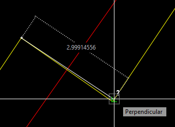

Kent1Cooper
in reply to: Luke_Y.AGII
Kent1Cooper
You didn't do it with high enough precision to see the difference, as I suggested.  Using your technique [yellow Lines], the perpendicular distance between is, and in fact must be, less than 3":

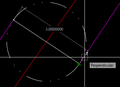

whereas drawing them TANgent to a 3"-diameter Circle at the middle:
As I said, it's not very much less in your approach at comparatively large size [and how much less will vary with the ratio of the diagonal length to the desired width], but it is less.  A more exaggerated example, with the desired dimension larger in relation to the overall size of things, so the difference, in Aligned Dimensions taken perpendicularly between, is clear even at lower precision:
Kent Cooper, AIA
Kent Cooper, AIA
