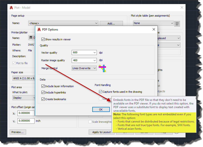

I've encountered a hiccup with Autocad 2019's DWG to PDF pc3 files output when there is a symbol in some text, dimension, or similar. Specifically, when I try to use the ± symbol (either by using the ribbon's pull down option or typing %%P). In the exact same file in AutocadLT 2013 (no changes at all), using the default DWG to PDF pc3, there were no issues, but using Autocad 2019's version (clean install) I get a message in Adobe Acrobat "Cannot find or create the font..." and instead of the proper symbol all I get are dots.
I've looked through the forums here and on Adobe's website and found lots of information that has helped me narrow down the issue. Here's a list of things I've tried so far that have not worked:
  • In the DWG to PDF - PDF Options I've tried capturing fonts used in the drawing (both checked and unchecked).
  • Reinstalling the true type font itself.
  • Plotting to all of the default Autocad PDF pc3 versions.
  • Copying the symbol directly in from Window's Character Map.
I then tried copying the string of text directly into MS Word and then converting that to PDF, and there were no issues. I also created a new Adobe pc3 plotter from scratch and had no issues. So I know it's not an issue with the font and Adobe Acrobat (especially because we never used to have this issue).
The problem is really, we have a ton of current renovation projects where we need plus/minus symbols in dimension strings and the drawings are already set up for the DWG to PDF pc3 printer. Going through them all and finding all of the ± symbols to convert them to +/- is no small job (even with the find command), nor is changing the plotter in all the drawings.
One last point, converting the text to geometry does display the symbol correctly, but the message "Cannot find or create the font..." still comes up when opening the file (which is not acceptable to send to a client). Also, changing the font to Times New Roman (and capturing the font) had no issues, but again changing fonts in so many drawings is unrealistic.
So, to me the issue is clearly somewhere in the font and Autocad's DWG to PDF conversion, but where? Anyone have any brilliant ideas?

It is a "legal" reason why the "technicn.ttf" is not embedded in the pdf file that was created with AutoCAD 2019.
This font is marked as "Font embeddability: Restricted".
You can check this if you open the properties on the file:
or navigate with windows explorer to the folder "C:\Windows\Fonts":
The core thesis for "restricted fonts" is:
Such fonts are not allowed to embed in documents that you distribute to users that do not own also a license for that font.
The conclusion is, that it is correct that AutoCAD 2019 does not embed the font into the pdf file.
To be sure that I'm right, I wrote a little C program to remove the "Restricted license" flag from the technicn.ttf file and installed that font again. Then AutoCAD 2019 embed the font in the pdf file !
The font is very old and things change. You could try to check at the Corel website, if there is a version from the font available which is "redistributable" (means it is allowed to embed the font).

m_latz
Hhm,
normally I have deactivated the tooltips, because it is annoying for me. But sometimes it could be very useful !
FontEmbedInfo-Enu-1.png regards
Markus

It sounds like you've hit on the issue and answer. I'm going to see if I can find an "unrestricted" version of the font, but in the meantime, at least I know why we're having the trouble.
thank you very much.
Message 19 of 24
Oakhillarchitects
After some messing around, that was exactly the problem, thank you so much!
