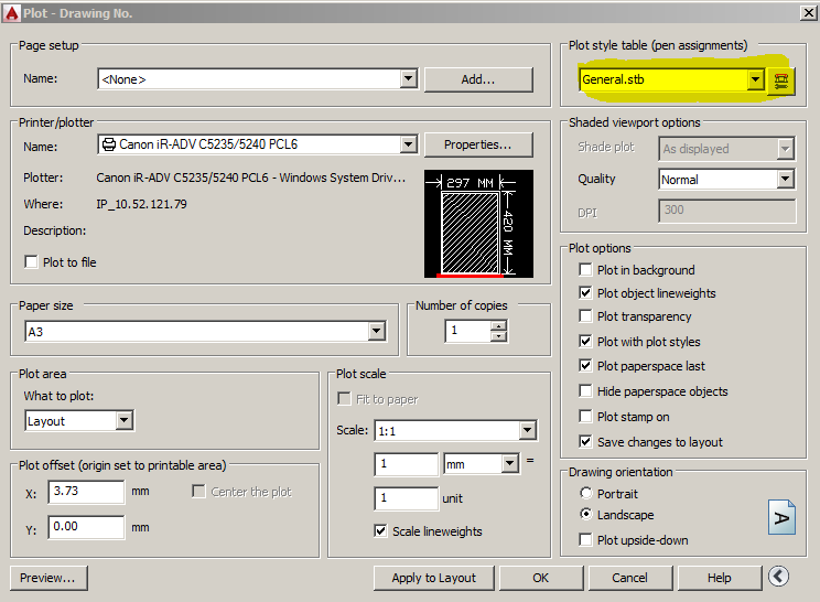

skintsubby
in reply to: Anonymous
Your drawing will be set to print either as "ctb" or "stb". When you plot look at the top right in the dialogue box it will quote either one of these in the "Plot Style Table (pen assignments)"
You need to look into editing the plot styles to see the difference these make, as these can over-write the settings from the layer manager.

skintsubby
It should be in the plot dialogue as well.... have you expanded the dialogue by hitting the arrow as shown below?
Message 13 of 15
pendean
Start LWEIGHT command and ensure the box DISPLAY LINEWEIGHT is checked on that pop-up: you an also use the slider to make adjustments.
And that's why I wrote EXPANDED POP-UP for the PLOT command, see screenshot above.
