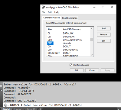

Message 5 of 17
imadHabash
it's work fine from my Aliasedit command .
