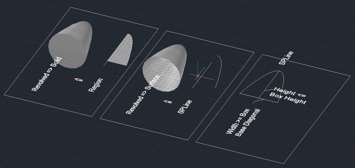

I am trying to make a solid that with a parabolic surface.
I plan to print a bunch or smallish parabolic surfaces with the intent of creating an array of parabolic mirrors to test the efficacy of a really inexpensive highly efficient solar heater. To do this I need to be able to vary the geometry of each parabola to have the axis and focus a bit different. I can create the mapping, the axis and focal point. What I can't seem to find is a means to create a square block with one side a parabolic surface in Autocad.
I understand the math but can't seem to figure out the mechanics of making it work with Autocad. I have Autocad Mechanical.

Perhaps this unit size paraboloid surface can be of use.  With the proper scaling and CV manipulation, the surface can be tailored to size and focus - then used with the Slice command to shape a side of a Solid3d block.  See attachment.
See manipulation in screencast:

A surface is more easily manipulated.  Eventually that surface can either be "Thicken"ed into a solid or used with the Slice command to carve a recession into a solid.

There are a lot of types of paraboloids.. If what you want is as @SEANT61 drawn, a circular base paraboloid cut to have a square base - not smoothly transitioning to the square base - then all you need is to create a parabola following your equation and revolve it , then intersect it with a box.. I Assume you need to follow specific equations for the parabola at least, so here is what you need:
1- Creating the parabola:
     - You can use this lisp, and since you know the math  - you can deduce the start, end, and  the top vertex, which are what this lisp requires..
     - The parabola base should be >= the diagonal of the square (equal to be start the paraboloid exactly from the square corner)
     - The parabola height should be < the height used for intersection, to have the complete paraboloid..
2- Creating the circular paraboloid:
     - Trim the curve to half.
     - If you want the result to be a surface, Revolve the half curve directly 360 degrees..
     - If you want the result to be a 3D Solid, Create a Region first between the half curve and straight lines, then Revolve the region 360 degrees..
3- 3DRotate the paraboloids to make them vertical
       (Or you could have drawn the parabola in the front view in the first place - with UCS set to view of course)
4- Create a box,
      - The sides of the box base are equal, and each is <= the paraboloid base /sqrt(2) (see the 1st condition of the parabola)
      - The height of the box should be >= to the parabola or the paraboloid height
5- Move the box from center to the center of the bottom circle of the paraboloid..
6- Use "intersect" and select both the paraboloid and the box..
If what you need is a soft transition to the square so that all points of the surface meet the square base - that's a very different story, it can be achieved easily in modeling  - but the equations will be a hell to go through..
