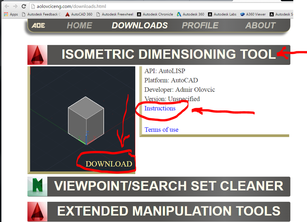

Message 6 of 12
I saw no link to download any Isometric dimension app, or is it already a program imbedded in CAD which will spring when I use the command.

You need to create a DIMSTYLE to do this in your template file(s), then import that unique dimstyle into your working files either through a toolpalette or drag/drop using ADCENTER command.
>>>...I saw no link...>>>
If you are referring to the above link, are you not able to click through as I show here?
