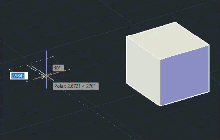

I'm using Autocad 2020 in windows 10 (or really Plant 3D, but the issues are related to standard autocad functions).
As long as i'm viewing the model at an angle, and not side/top view etc., I have always been able to draw simple lines in the z-direction using polar tracking without changing the UCS or typing coordinates, but now it will not let me.
The same goes for moving objects in z-axis.
Anyone have a solution for me?
I have tried a lot of different options and all googling just tells me to change the UCS, but that should not be necessary and makes my work a lot less efficient. I have been using Autocad for 15 years now and this haven't been an issue before.

Message 14 of 26
karlg.paulsen
Ortho doesn't help much, and its behaving weirdly. As you can see in the gif below when i try to draw a line in z-direction it moves in the opposite direction and less than the corsor.
Same when trying to move objects

karlg.paulsen
BTW this is what im trying to do. I had to download the 2018 version to demonstrate.
As you can see the line is drawn continously
And here is me trying the same in 2020 version
Message 17 of 26

karlg.paulsen
Both videos are in Plant 3D, but i didn't expect the standard Autocad tools to work differently in Plant. Thats why i posted it here.
BTW. When i use ORTHO in a standard view (top, right, front etc.) or WCS it works as it should, but not when i'm using a custom named UCS as my project uses.
