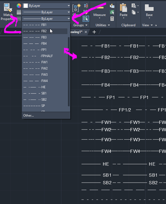

Can you share that problem DWG file here?
@bthomas_tta wrote:
...the SP and SR linetypes.  But, those are just dashed lines, same as the dashed lines in...
That's all the definitions are designed to do
I'm not seeing any issues using that LIN file in AutoCAD here, try the attached in your older 2000i AutoCAD
