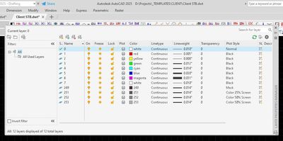

Here's my template for the client.
Just curious, why can't I have a clear enough image into this forum I used Snagit and Snipping Tool, the same result on the posts.

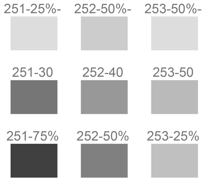

You may want to take a look at your screening of colors.
Currently your screenshot shows them assigned to the following client stb plot style screens:
251 = Color 25% Screen
252 = Color 50% Screen
253 = Color 50% Screen
I've created now additional swatches in the attached drawing based on your current stb screen assignments:
I don't think the digital hardcopy (pdf) is going to give you the look of how you've configured your ctb for those 3 colors:
Color 251 should be darkest, 252 should be less & 253 should be the lightest.
But if you use the stb plot style screen assignments then the result is not what you want:

omorah
There really something I am not understanding; excuse my slowness.
Attached is my office setup I had made. The lower the number the lighter.
With the higher numbers, I only use 249, 252 & 253. The STB has 253 as a 50% screening, which is what I need.
Thanks. I again, appreciate your time.

paullimapa
Ok, I was not aware that your office standard ctb is setup so that the gray color intensity reverses from the natural gray color.
Because the natural gray color (when there's no screening) Color 250 is the darkest gray whereas 254 is the lightest
So in this case it makes sense that Color 253 with your ctb screened at 50% is the exact same as your client's stb Plot Style of Color 50% Screen
This would give you the same look when printed.
Now since your office standard ctb has Color 252 screened to print as a lighter gray than Color 253 then you'll have to determine if assigning this to your client's stb Plot Style of Color 40% Screen would give you this look.
