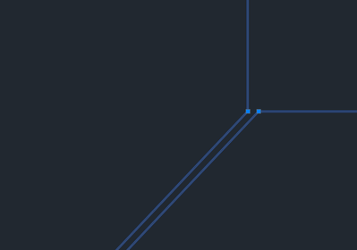

josemiguel5TJSU
Is this what karfung wants?
To leave a whole like that, you need a microscopic gap like so:
(xclip won't allow overlapping polylines or disconected polylines as a clipping boundary)
Normally people use the wipeout method, allready suggested by  imadHabash.
If you want to inspect my attached drawing use the command XCLIPFRAME to turn on the clipping boundaries.
