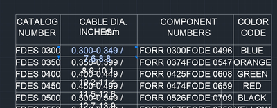

Hello. I am having an odd issue I cannot figure out how to solve. When trying to copy text from one drawing to another the Mtxt takes whatever is in the text box and makes it into 2 lines. The text is not set to annotative and I checked all the text sizes and settings and they match between drawings. I cannot figure out what setting is doing this if anyone has seen it. Picture 1 is what the text should look like
and these pictures show what is happening when I copy it

yeah they had the same text style. IT was the "standard" one that you cannot delete. I checked the settings and it appears they are the same in both drawings. I am not sure exactly why the font is changing we I copied it. I fixed it by just making a new text style and bringing that in.

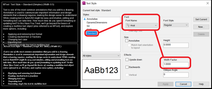

This will happen if the Font applied to the Standard Style is different in another drawing - as @rkmcswain mentioned.  You just have to pay attention to the details and modify as necessary.
Look at the text from Drawing1 (Using Standard Text Style = Simplex = 0.5 Width) when copied into Drawing2 (with Standard Text Style = Arial = 1.0 Width).
