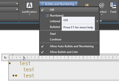

I'm using AutoCAD 2017 and when using bullets in the MTEXT I get this result when trying to tab:
I could not find an indent button anywhere in the editor or the ribbon.

I assume that you don't want any bullets in front of "Add". Just put your cursor there and turn off bulleting.bullets off.png

I don't understand. You never really stated what the problem is. The picture you showed has bullets on all lines.

The issue for me is that it displays two (2) bullets when the text is indented (red circle on image in original post). I don't remember this behavior when using previous versions; not sure why it does this. I want to emulate a word processor where I can indent and still have a bullet.

Most bulleting/outlining also indicates the level of indenting. In a word processor, you can change the style of bulleting. But AutoCAD's mtext editor is not as advanced. It just has the one style of bulleting. I suppose you could turn off bulleting for that line and insert a special character instead of the bullet. Personally, I don't mind the two bullets. It distinguishes the line.
