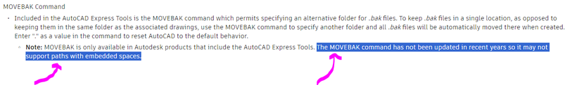

averdam
No, this is what it is.

I would also like to report the MOVEBAK issue.
I'm running AutoCAD 2025 on a Dell XPS workstation.  I have MOVEBAK set to save any .BAK file created to a designated folder on the D:\ drive.
1.  I first open the program and start an existing drawing.  When saving this drawing the .BAK file is saved to the same folder as the existing drawing.  MOVEBAK does NOT save the .BAK file to the folder I have designated.  I can then call the MOVEBAK command and the command on the command line shows the designated path to the folder (between the carats).  I hit ENTER, and then subsequent saves will result in a .BAK saved to the folder path I designated in MOVEBAK.
2.  When first opening the program and then starting a new drawing, I save the drawing to a folder with a new filename.  Subsequent saves will produce a .BAK file in the same folder as my new drawing.  Then, as above, if I call the MOVEBAK command and hit enter, any further saves will result in a .BAK file saved to the appropriate folder designated in the MOVEBAK command.
I tried to make this as clear as possible.  MOVEBAK will work, but it has to be called from the command line every time I start AutoCAD 2025.  This behavior does not occur in AutoCAD 2024 or 2023, also on this same computer, using the same folder designation.
So there is a workaround, but having to start MOVEBAK every time I start AutoCAD 2025 is annoying.  I just don't remember to do it every time.  I tried to include the MOVEBAK command in my acad.lsp file that runs before every drawing instance, but AutoCAD halts the .LSP file when it gets to that command.  I imagine the acad.lsp file will not run Express Tool apps.  At least not this one.
A fix would be much appreciated.

Not sure why movebak.lsp has a different behavior in 2025 but here's the acad*.lsp load order:
acad2025.lsp
acad.lsp
(These two files are only loaded at first startup, unless the ACADLSPASDOC system variable is set to 1)
Next comes Autodesk’s acad2025doc.lsp (this is where Express Tools functions are autoloaded)
So if you attempt to call the movebak.lsp function from within acad.lsp, this will fail since Express Tools has not loaded yet.
Since next to load are what's inside Appload StartUp Suite, see if you're successful by placing the movebak.lsp here.

That worked.
I copied MOVEBAK.LSP from the Express Tools folder to the folder I use for my APPLOAD routines (not strictly necessary).  I started APPLOAD, opened the Contents under the Startup Suite on the lower right of the dialog,  and added MOVEBAK.LSP to the list of applications.
MOVEBAK now operates correctly for new and existing drawings.  Thanks for the effective workaround.  I still think AutoDesk needs to fix this function so it operates correctly without this workaround, else they'll have a lot of users searching for this forum topic!
