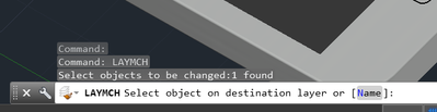

john.vellek
Hi @ВeekeeCZ,
Laymch is similar but requires an existing object on the destination layer or the name has to be typed. It might prove useful for the OP however. Thanks for the contribution.
John Vellek
Laymch version
One extra little step to get a list.
John Vellek
