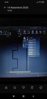

Hello! I exported the wall behind the bed from 3dsmax and cant modify the width of the line( i can't make it thinner but wider yes) . This problem applies to all the exported models( see the night stand) and what is to be done? The objects are 3dmesh and there is a way to convert them to 2d? Please help

you may need to turn OFF  LWDISPLAY ( System Variable ) .
Command: LWDISPLAY
Enter new value for LWDISPLAY <ON>: off
