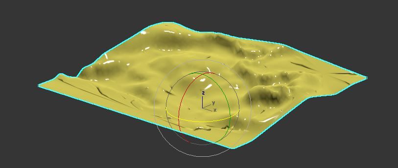

The fact that you plan to export the final model  as an STL file somewhat negates the need for a smooth surface as an STL file will have  tessellated any smooth surfaces.
As an experiment I imported the AutoCAD solid model into 3ds Max and applied a turbosmooth modifier.  Here's how it looks in Max.
And then converted it to a .dwg file in Max.  Here's how it looks back in AutoCAD.  It's a mesh surface which would require using surfsculp to convert it to a solid.
