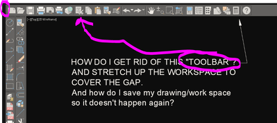

@MarkFitz can you provide a screenshot of what you are seeing?  sometimes just providing a picture can help generate an answer a whole lot faster than trying to describe your issue.

Here are the before and after (ignore the text in the before pic, that was from a previous question, I just happened to have and old screen shot of this)
ACAD Setup is the after
ACAD Workspace is the before, i.e. what I would like to get back to.

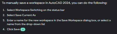

This is a toolbar: simply reverse the process that you followed to get rid of it?? Do you need help finding that previous post of yours?
To turn a toolbar on, you simply restore the WORKSPACE you saved previously when you set it up. Don't know how to do that? Try this
