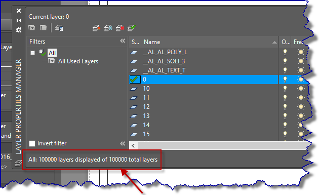

Just to test this I have created a small loop which created 100000 layers (using AutoCAD 2016 64bit), no problem (besides of performance issues, e.g. when loading the drawing or opening the layer-manager).
It might crash with that amount of layers, and I also don't know the real limit, but it was possible to create 100k layers.
The more important question is can anyone work with drawings with that amount of layers and the killing performance in that case.
Can you describe the reason when and whatfor you need such an amount of layernames?
- alfred -

I can't even imagine how horrible the performance would be with that many layers.  The Layers Property Manager bogs down as it is with 200 layers.
So it seems there's no limit for unsorted layers and 32,768 layers sorted (starting from 0 instead of 1 gives you an extra layer in the count).
