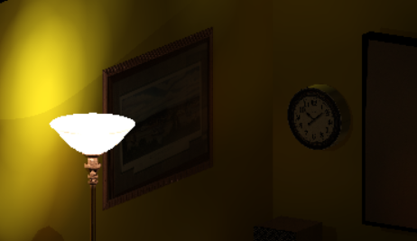

I am working on a model of a house.  I go in and add models for pictures to the walls.  I them add an actual JPG material to the picture model by attaching the material to the model.  Then I use Material Mapping to manipulate the image in REALISTIC view so that the JPG covers the area that I want it to and I make sure that it is positioned, rotated, moved, so it appears to be in the right spot on the screen.  Then I render the image and the material will appear shifted to the left and down in the rendering.  What is going on here?  I included 2 images so you can see what I'm talking about.  One image shows the model in AutoCAD how it appears to be in the REALISTIC mode and how I used the program to place it and the other one shows the rendered view with the shifted material.  The round cylinder that looks like a plate on the adjacent wall is actually a clock and I attached the face of a clock to this model and rotated, moved, positions this so it appeared in the right spot too and you can just see that just a sliver shows up on the left side of this model.  What am I doing wrong?

I looked to the clock for now and yes, it's strange how the texture is bound to a specific location. When you move the clock the texture stays at a location independent of the position of the clock.
And I don't have any idea why that happens (well, it might depend how the geometry for that object was created, but not sure at the moment).
The solution might be:
  • create a new cylinder
  • assign the material to that new object
  • run command _MATERIALMAP and assign the mapping coordinates ... the gizmo can then be moved and resized (using it's grips) to make the image of the clock fitting to the geometry.
One word to image sizes: your 2 images (IMG_0505 and IMG_0507) have about 5000x4000 pixel. I guess you never render your camera views to a size of 5000x4000. So the resolution of the JPG files can never be reached for your output ... but they cost render time. Reduce them and your rendering will speed up significantly.

I was wondering if the size of the images had something to do with it but I just went into a new drawing, made a rectangle, attached one of the images with the same file I sent you that is 5000x4000 (I have to lower the resolution of my camera), and it looked exactly the way I wanted it to look.  One more question.  If I make a model and attach an image to it and save the file, and then insert that file into a larger model, in this case the house model, if I rotate the model, does the image get messed up and I have to rotate the Mapping Materials?  I did that with a couple of things in this design.  One being the clock and one of the pictures I'm having a problem with.  The reason I did it this way was because this model is getting pretty big and it has some lag when you build the models in the entire assembly.  Is there one way that is better then the other for work like this and could that be what the problem is?

I too saw this behavior. I rebuilt the clock and remapped the material to it. I remapped the Boat picture too and now they both seem to be behaving better.

I tried playing with your clock and it looked like the material was on the back face so I created my own.

I'm having strange results now.  I never used your model, I wanted to figure out what I was doing wrong.  So I went in and did like you described and made a new model for the pictures in the living room and the dining room and attached the images and I rendered to the cloud and they looked like I wanted them to look.  Then I tried to render them on my computer and the images shifted again.  Is this a graphics card issue that was brought up before in this post?  Have you ever seen these results before and if so, what was the problem?
