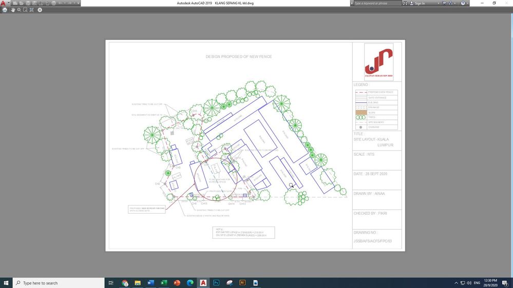

The blue lines are supposed to be thicker than they are showing on this screenshot:
What is the difference between lineweight and linetype scale?
I just want the lines to show thicker when I look in paperspace and when I print.  I thought that was called lineweight.  Am I asking the wrong question?

Activate your Paper Space viewport by double-clicking in the viewport.  Then turn on Lineweight display.  Deactivate the viewport by clicking the Model icon at bottom center or double-click outside of the viewport.
I typically do not display linweight while working on the drawing but instead on when plotting/printing.  There is a selection in your print dialog for printing lineweights.
The difference between lineweight and linetype scale has to do with pen/pencil width vs. the resolution (or frequency) of dots and dashes.
Hope that helps.

I found that your "lift" block is made up of three-thousand-one-hundred-ninety-nine entities!  I just had to spell that outSmiley Happy
The object does not appear to need that many.  I used Delete Duplicates (Overkill) in the block editor to clean it up and there were 62 duplicated and 706 overlapping objects.  I then looked at the many layers that the block objects lived on and I must recommend consolidating all these objects to the zero (0) layer with ByLayer color, lineweight, linetype assigned to all the object while selecting and view properties.
Now back out to the drawing editor... The offensive blue lines are assigned .6mm lineweight while other objects are assigned ByLayer and other various values.
This is MESSY.  You need to get your drafting standards together and use layer assignments to control colors, lineweights, and linetypes (to the best extent possible).
Copying these objects to a new drawing WILL transfer all of the object settings along with.
No ofense intended but you need to recognize the huge mess within Properties for your drawing objects and blocks.  Blocks will behave flawlessly when they have root definitions for objects on zero layer with ByLayer settings.  You can then simply insert them or move them onto your desired layer and they will inherit the settings for the layer.

So the fast fix I just completed is to select everything on screen and set color, lineweight, and linetype to ByLayer.
Next go to your Layer Manger and change all of the non-Default lineweight to Default.
Every line and object displayed will have the same lineweight when printed or displayed in PaperSpace.
Work forward from that point altering layer settings to achieve a good technique.
