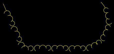

I am trying to create a new linetype for a hedge. I have already tried it with revcloud an also tried the 'mkltype' function but it doesn't give the result wich i am looking for. I have attached a screenshot wich i like to create.

If you make the three Arcs into a single Shape for a linetype, or either select them together or define a Block for an Associative Array, you will get this kind of thing on paths that are not straight:
[i.e. overshoots at bends and at the end].  But if you define Linetype with three Shapes, one for each Arc, that effect can be greatly reduced.  However, it would have the usual linetype issue that there will be straight pieces at the ends beyond full cycles of the linetype definition, something like this [faked approximation]:
