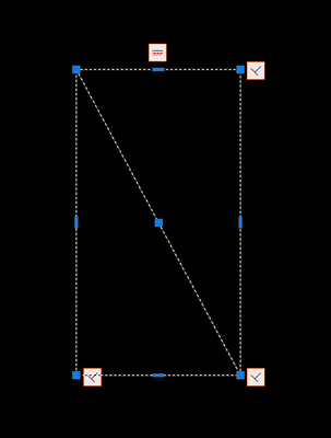

Hi All,
As said in the title, lines and polylines are connecting automatically. I've tried to add an example of the problem: https://imgur.com/a/0qlKBpi. The square is a polyline, the line within the square is just a line drawn separately from the square. If I move the vertex of the line the square moves along as well. While moving the vertex I made sure I only selected the line I wanted to move. Only the command explode seems to work, but I don't want to explode my drawings for obvious reasons.

your attached images didn't help , would you please attached here your CAD dwg sample , for testing ?

Thanks for the quick response! I've attached a test file.

your line is constrained use DELCON  [DELCONSTRAINT] command to solve your issue .

That works, thanks a lot!
imadHabash
also make sure that CONSTRAINTINFER = 0 ( zero ) . >> Click <<

Sorry ... it's important also to know that from CONSTRAINTSETTINGS command you can tick those options ( see below image ) .
