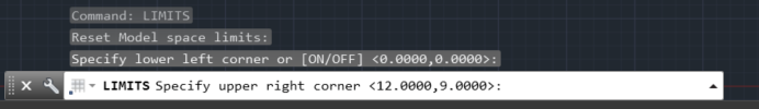

at the command line enter LIMITS
leave the Lower Left Corner alone select ENTER
change the Upper Right Corner to something like 500,500
