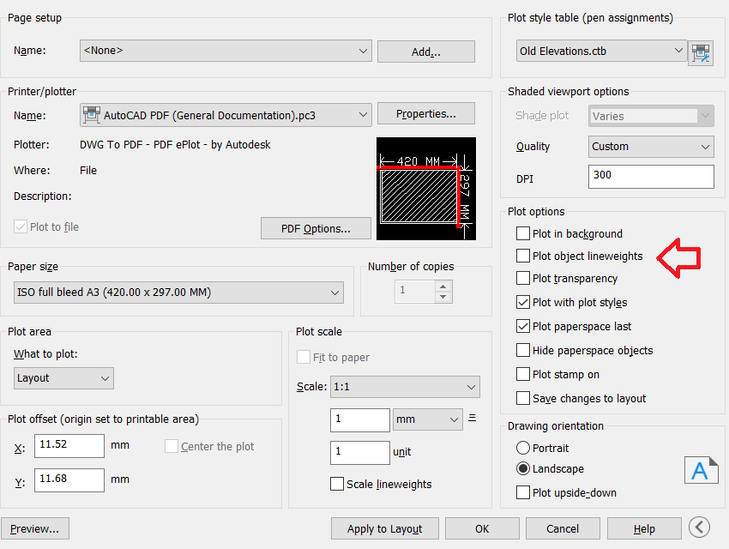

I'm working on a set of elevations (drawn in Model Space), I've set line widths for different elements by colour (nothing unusual there). I'm using a plot .ctb file i've used before (without issue). Line widths set by colour. I've a titleblock and 4 viewports in Paper Space, 1 VP for each block of elevations. The problem is the line widths shown in Paper Space (I have Display Plot Styles ticked in the Page Setup Manager) and also that print from Paper Space come out far to thick and don't reflect the pen widths set up. They do print correctly directly from Model Space only and I don't know why.

There are most likely multiple things to check. But first easy checks are:
  • Make sure your PSLTSCALE, MSLTSCALE, LTSCALE are all set to 1.
  • In Page Setup Manager make sure under "plot options" that you check the boxes for "plot object lineweights" and "plot with plotstyles". Also under plot scale I usually uncheck the box for "scale lineweights".
If those couple of things don't work, then please upload your drawing and CTB file so it can be tested out.

Uncheck Plot Object Lineweights.
You are using color to control so it seems that is the trick.
I did that and my prints look like the good print you supplied.
Hope this helps.
JRR.

Unfortunately switching off "plot object line weights" makes all the lines default to 0.25mm (which I had to do to get it to the client looking semi normal)

I checkt you files and i checked it on my side too, i can not see any unexpected things an no difference between
the programs.
The only questions i have are user related and perhaps you just expect the wrong things
or used the wrong setting without to know.
1. Why do your uploaded two PDF, created by different plot drivers?
Use the same one (AutoCAD PDF...pc3) and compare it again, is it better for you know?
2. Why do you  compare a small A3 with a big A1?
    It is not a problem, but in your PDF viewer it can look unexpected - if you not familiar with that.
 Use the same papersize (full bleed A3) and compare it again, is it better for you know?
If you are not happy with the result, please share your PDF and Screenshots
where we can see what you talking about.
Sebastian
Message 7 of 33
cadffm
like to edit my post this way:
 (or just using the same scale, but you plotted the model much bigger than the layout, what looks like "thinner")
Your Layout PDF is correct! also the Model PDF,
Just different settings and result, but the lineweights are correct in both files.
