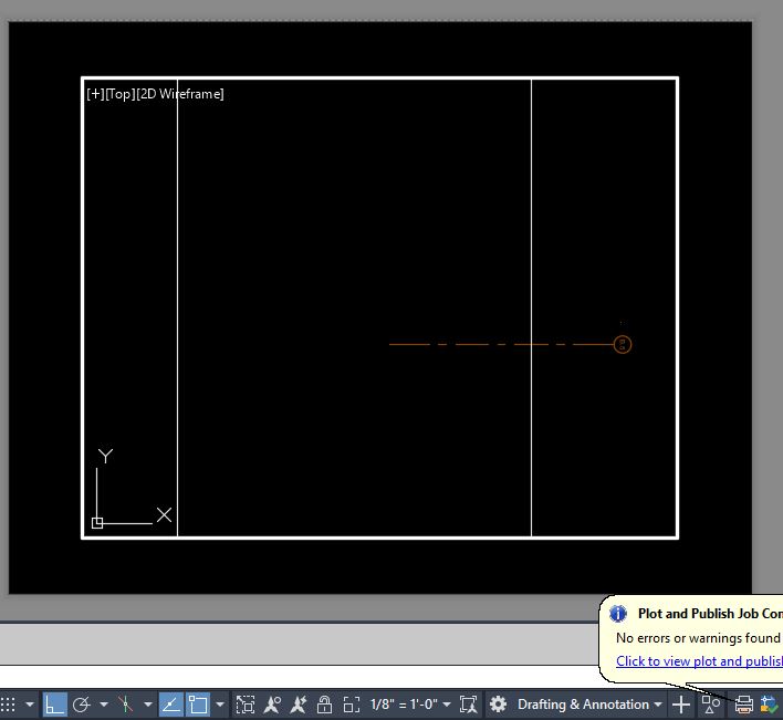

I have a block that annotative. Its a column bubble for grid lines in a building. The bubble and text scale to the viewport, but the grid line is a constant length. If I stretch it in my 1/8" viewport, then in my 1/16" its twice too long. How do I get it to scale right?

here are my plots. 1/16 and 1/8. the 1/8 does not extend the line

You posted the same image twice @jriseborough
Sadly it does not change the fact that over here I cannot reproduce your issue in your files. Check your settings for ANNOAUTOSCALE and ANNOALLVISIBLE, mine are 4 and 0 respectively, and my graphics card regens in time with AutoCAD, if yours does not try forcing it using REGENALL command

I guess I dont see it working for you either. Perhaps I am not explaining what I expect. For the 1/16" shown, the line in the block is across the second line on the left. For the 1/8" and 3/32" its not.  Shouldnt the line stay in the same relative place?

@jriseborough wrote:
...Shouldnt the line stay in the same relative place?
That's a different question from the original: it all depends on the object's insertion point relative to the other content
And if you need to use ANNORESET command to remove any manual grip edits performed in some viewport scales so they all match up.
