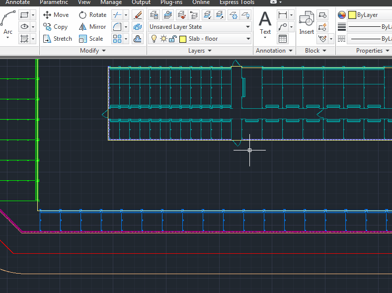

Hello:
Let me preface by saying that I'm just learning to use Autocad. We have version 2012. I just created quite a complex drawing. I was trying to separate all elements into different layers with their own colors and such. (For easy reference.)
So I decided to test my drawing by switching off layers in this palette:
undefined
But when I was turning off my layer "Bldg M" it would remove only some of its elements.
When I start selecting objects in the drawing screen from the layer "Bldg M" it shows them in the drop-down (shown above) as being in the layer "Bldg M". Hmm. But when I turn off that layer (again, as circled above), it doesn't remove them...
To see where those objects could be I also started turning off other layers, and it turns out that if I turn off layer "Bldg S" most of my objects from the layer "Bldg M" are also taken off the drawing area. But, again, when I select those objects in the drawing area they show (correctly) to be on the layer "Bldg M" in the drop-down control.
So in other words, I am totally confused????
Another weird thing that happens is that all objects on layer "Bldg M" were inserted as (my own) blocks using this button:
undefined
but when I turn off the "Bldg S" layer, it takes out some objects but leaves parts that were not supposed to be added as parts because they should've been inside the blocks and I could not've added them as parts.
So please let me know what I did wrong and how to correct it?

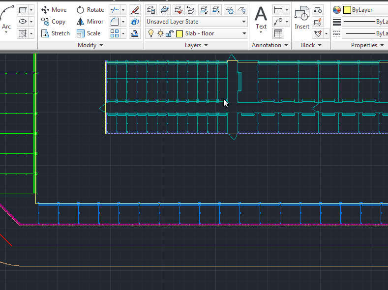

Thanks for your reply, Alfred.
I'm sorry, if I'm still not following it. Instead of trying to explain I made a short animated GIF to show what happens. Please take a look:
undefined
And to show that the part of the drawing consists of only blocks, I made this one:
undefined
So why are those layers not being turned off? And why do I get those parts left out?
nestly2
The block is on layer "Bldg - M", but the objects inside the block are on several different layers.
The only way to hide all the objects inside the block by turning Layers OFF is to turn off ALL the layers that are used inside the block.
Similarly, if you FREEZE the individual layers, the corrosponding objects will disappear, but you can also hide the entire block by FREEZing only the layer the block is on.
Also, since the objects inside the block have a color property of "BYBLOCK", everything inside the block will ignore the assigned layer colors, and instead use the color of the Layer the block is inserted on  (unless the whole block is assigned a color override, in which case it will use that color and ignore all layer settings.  So if the intent is to have objects inside the block display according to their individual layers, then you don't want to use "BYBLOCK" because the block can be only one color. "ByLayer" would be the correct color choice in that scenario.

Thanks. I get it now. My mistake was to set up elements in each block as "by block." Changing them to "by layer" and setting a specific layer that I want them to be on fixed the issue.
