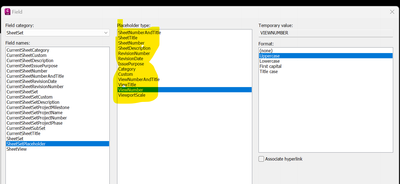

This image shows the options from sheet sets that can be used as place holders with no possibility to reference xrefs. It may be a 3rd party solution, a solution using property sets or lisp exists. I would post on the C3D customization forum for help with that latter.
