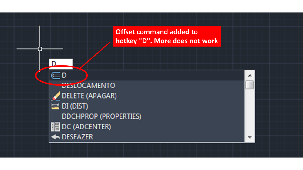

hello guys i need help from your dear knowledgeable minds. I want to change the UndoDiapositivo1.PNG command shortcut key. I've tried some alternatives like CUix, but it didn't work. What do I do?

if you are asking to make your Undo command active with D letter , then type ALIASEDIT command and Modify it .

Instead of altering the CUI, try using command "_.ALIASEDIT" to assign a shortcut key for the UNDO command.

I use AutoCAD in the Portuguese language. in the alias shortcut list theUNDO command does not appear. So try it with CUix. Do you know another method @imadHabash?
imadHabash
press first the Edit button then in the second dialog do what you need .

@imadHabash @vinodkl
Offset command added to hotkey "D". More does not work.
I want to add the shortcut key "D" for the OFFSET command. But the AutoCAD Portuguese 2020, in its Alias ​​command list does not present the OFFSET command, despite this deficiency the command accepts any other type of shortcut key with the exception of the “D” key that is added to the UNDO command. Thus, it becomes almost impossible to add the shortcut key "D" to the OFFSET command because it is added to the UNDO command.
