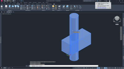

I am currently working on adding walls to a 2d flooring plan.  I used POLYSOLID to create the walls, and I am now adding windows.  I created the first window out of a box, then ran SUBTRACT to create the hole in the wall.  After I ran the command, it returned "no solids, surfaces or regions selected".  I tried again, same result.  I deleted the box, replaced it with a polysolid and got the same result again.  I extruded the window solid to make sure I was selecting it, same result.  I offset the lines I was using as a reference for height, and got the same result.  I restarted the program, and the issue remained.  I am not using meshes or blocks.  Is there something different between a polysolid and a normal solid?  Should I redraw the walls using the box command?

Tried making it longer, stuck out on both sides of the wall by a foot or so, still returned the same error.  I'm thinking it's probably a software issue so I'll try completely shutting down the program, making sure all autodesk programs shut down in case it leaves one in the background, and then if that doesn't work, possibly reinstalling.  I tried just making a box with a cylinder through it in a new drawing and it gave me the error then too.

That is what I am trying to do, yes.  I tried your suggestion of making the box a lot longer on both sides, it still gives an error.  Given that it appears to work for you all, it's not a problem with the file so it's either a problem with the program itself or it's something about my computer that's acting up.
