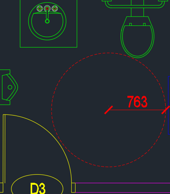

I recently changed the LTSCALE for some of my dashed lines to 150 so the dashes could appear more noticeable in the Model. However, when I look in Paperspace the size of the dashes are much too large (see images below). I've tried a couple of different suggestions that I've seen online but nothing seems to fix it. Any suggestions would be very appreciated.
Dashed lines in Model:
Dashed Lines in Paperspace:

if you never need to plot in model tab then leave the ltscale alone.
if you only have one vport in layout tab then you can always turn off psltscale = 0 then ltscale value will always govern in both model & layout tab
psltscale = 0
msltscale = 0
