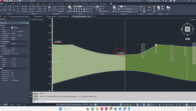

Our workflow is as follows:
We extracted top and bottom elevation values for each layer of the profile drape.
Along the alignment, we generated offset values at every 2m interval.
For each point, we have X, Y, and Z values.
The Z values are obtained from the 2D polyline using the corresponding X and Y coordinates.
However, while converting the 2D profile into a 3D solid, the software is not supporting the operation and the extrusion/solid generation is failing.

@Shashikala_CRADTS
After looking at the image, I suspect the solution lies in the UCS orientation. It would be helpful if you could send the drawing itself so we can assist you better.

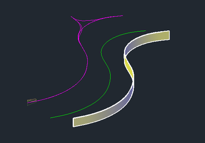

Rather than deal with a 3dpoly with an excessive number of verticies (>6000) representing both sides of the drape create a spline with a dozen or so fit points for one side of the drape edge.  Extrude the spline and use thicken to create a solid.

I used the Excel data to create two 3Dpolies then lofted a surface between them.  Thicken was then used to make a solid.  Is this the result you want?   I think extrude of a non-planar surface was what was giving you a problem.
The attached file also has a solid created by lofting a spline.  The spline's tolerance is about 0.05.  You could get better fit if necessary by using more fit points to define the spline.  I prefer going the spline route as it yields more efficient models but the 3dpoly works!

Workflow to created Closed profile drape
1. Enter 3Dpoly in AutoCAD
2. copy excel data and paste into 3Dpoly and
3. Enter close option.
After that one closed profile will be created that profile, we are trying to do extrude into 3D solid but it's not working. I tried UCS change into view for that also same its working for outline of the closed profile drape.

Loft from a top curve to a bottom curve then thicken.  You cannot extrude a non-planar shape.
