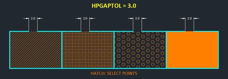

You can do it. Try this.
Use HPGAPTOL on you hatch. So far, you’ve experimented with Spline-This-and-That and Polyline-This-and-That. What you haven’t tried, though, is investigated the hatch component of your opening post. Try using the HPGAPTOL variable which addresses the boundary, or more specifically, the gap on your hatch area.
You can set you gap tolerance in the System Variables dialog window. Simply go to Express Tools tab=>Tools panel=>System Variables button. The default value is 0 which means only ‘closed’ boundaries will accept hatch. See image-1.
Image-1.Image-1.
You can also set the gap tolerance in hatch settings. See image-2.
Image-2.Image-2.
The strange thing about the HPGAPTOL variable though, is its behavior. Sometimes it performs as expected while at other times it doesn’t. Too bad, although it’s a good way to hatch areas without having to mess around with closing the space in between lines its unexpected results make it somewhat difficult to work with. Here’s an exercise I performed to illustrate the whacky behavior.
EXPERIMENT 1:
I started with 4 polygons, each with identical dimensions and each with a gap measuring 2 drawing units wide. I set the HPGAPTOL to 3.0 which is greater than the actual gap. I then hatched each polygon using a different hatch pattern. Using the SELECT POINTS option of the HATCH command, the 2.0 gap was ignored and the polygon was hatched as expected. See image-3.
Image-3.Image-3.
