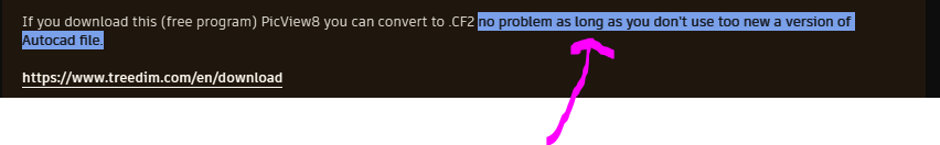

If you download this (free program) PicView8 you can convert to .CF2 no problem as long as you don't use too new a version of Autocad file.
https://www.treedim.com/en/download

ADITHYA_CHALLAPALLI
