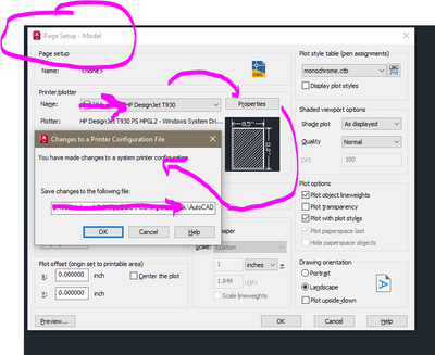

When in Page Setup Manager (AutoCAD 2024), Modify, Plotter is Selected, click on 'Custom Settings', I select monochrome and then in Paper tab- I select Rotate 90 degrees (to save paper). Then OK, close ect. I go back and find everything reverted back to the Default Settings. My Plans Plot out turned wrong and I gotta cut off 6" edges. Why wont the Settings I put in as I always have, Stay Set? I just bought the 2024 edition and I wish I still had 2023.
Foe me, AutoCAD2024 stops to ask me if I which to choose a permanent PC3 file or not, just like in 2023: I see you make no mention of that in your post, are you not getting it?
Message 8 of 13
MyTymMachine
Yes each time I do save the changes to the plotter file, doesn't seem to

I face same problem... then I try this.. Edit the SYSPLOTCFG system variable and set it to 1.
my problem solved!
