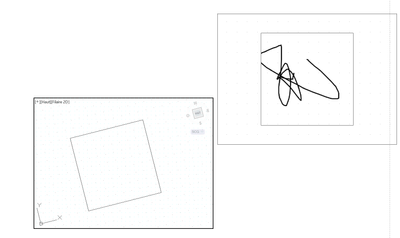

I have autocad 2023.1.5 and I have find a bug (very hard too find but it's reproductible), you just insert a image (for example _insertOB and paintfull) and if you move just few angle in orbit, image desapear in presenation and don't want to be print. Very frustating thing...

From GRAPHICSCONFIG command ,Try disabling "Hardware Acceleration" and test the orbit again.

OLE objects do not support rotation and will become invisible when viewport is rotated

thnaks, only solution I have find curently is too create a new SCU and insert OLE, and it's okay but not a good solution.

You can insert reference the image as an XREF and then they can be rotated.
https://www.autodesk.com/support/technical/article/caas/sfdcarticles/sfdcarticles/Rotating-OLE-objec...
Note that the image won't be inside the drawing but linked, when sharing the drawing with a third party you'll have to bind the xref or supply the original image(s) along with the drawing
