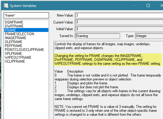

FRAME changes all the other *FRAME system variables so if IMAGEFRAME is 0 then FRAME is changed to 1 the image frame will print. Is there a background plot routine running that changes FRAME to 1?

FRAME is 3 (which means that some of the frame variables have different settings to each other)
However, if I set the preferred value for FRAME to be 0 in the SYSVARMONITOR, and click 'reset all' on that dialog, it will state that FRAME variable is now 0 but it will still plot the frame.
In order for it to not plot the frame, I need to manually set the FRAME or IMAGEFRAME variable to 0 (or, if it has been reset to 0 in the system variable monitor, I need to change it to a different value and then back to 0) in order for it to not plot.

I tried using SYSVARMONITOR to change FRAME to 0 and it appears to work but when you check it is always 3. I assume SYSVARMONITOR runs through the list so sets FRAME to 0 then IMAGEFRAME to 1, thereby resetting FRAME to 3. You need to set FRAME and IMAGEFRAME to 0 or 2 for it to work as expected.
