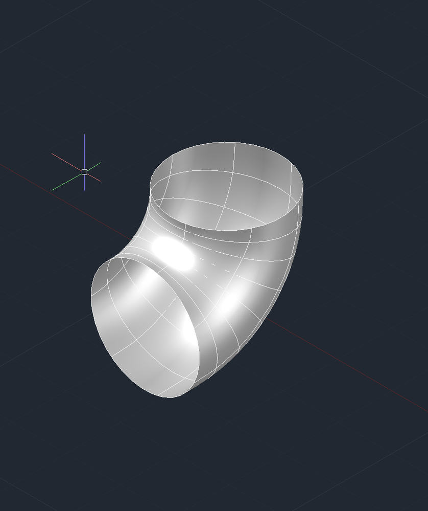

I have 2 circles that are vertical to each other, and I have been trying to create solid loft between them. No matter which method from the forums I tried, I was not able to convert my loft to solid. I am now posting here in hopes one of you will be able to help me. Any help or advice is greatly appreciated!
This is the shape that I need solid.

move the path to the centers of the circles, offset to the inside of the bend, the loth
parkr4st
Then LOFT!

Well that is what I did (loft between the two circles that are now the ends of the tube).
I did manage to get what I needed in the end by creating two boxes, uniting them, and then using the filletedge tool to make it all round.

was the MODE in LOFT set to SOLID?
