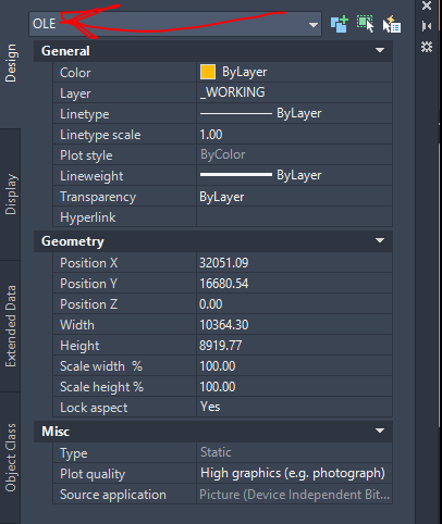

jrsSYSCB
Thank you for a prompt response. So far, it seems I was able to get it working by bringing it in as an OLE.
I guess I’m more interested in knowing now why the template always opened with the JPEG logo  in place but not once it was saved as a new file and closed/reopened.
im guessing it’s  because with a jpeg attachment its just referencing a file - but im confused as to why it continued to remain in the template file

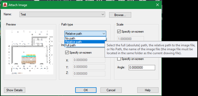

Attach image files (like Xref dwgs) require a path type which is an index reference to the location where the file in this case a jpeg file resides:
If you use Full path (like a network location) that full path can be found again when that drawing is opened within the network. Then you'll see the logo.
If you use Relative path and when that drawing is saved in a location (even within the network) but that's in a completely different folder structure then it can no longer locate the file.
OLE on the other hand actually Inserts your jpeg file as a permanent object in the drawing just like an insert BLOCK. The difference here is that if you ever changed your jpeg file, the inserted version won't automatically update.
But the attached version will automatically update.
