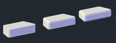

Hi @Anonymous,
I would start with drawing the top and bottom edges. Then create the short angled side.  Next fillet the edge with the top and bottom. Last, you can mirror the edge and fillet corners.
If you then want 3D, use PressPull to give this outline some thickness. If you want want to curve the edges you can then apply a FILLETEDGE.
Capture1.PNGDoes this help or do you need something totally different?
