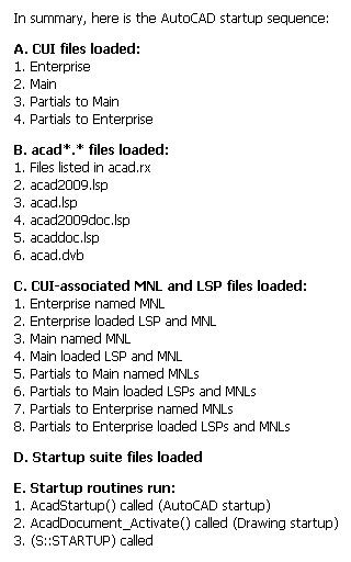

Do a search here for key phrase "load order", "startup sequence" or similar to see
the sequence of third party interface points verses when the plugin(s) is loaded.
Image below is a screen capture from 2014 (of unknown origin).
