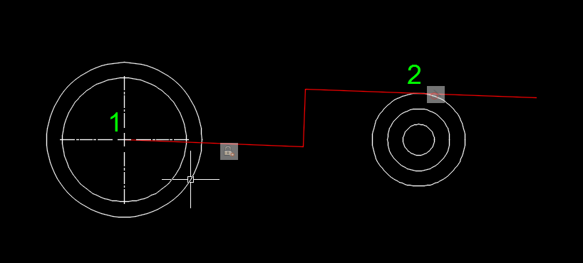

eng.jpgjust to be clear, here's a screenshot. Need to rotate an object(without deformation) through 0,0 rotation axis so that it will tangent circle (any one) Thanks!

Hi and Welcome to AutoDesk Forum,
what a great question.. all the answer exist in PARAMETRIC values and i will explain it for you step by step :
- convert your object (red lines in the image) to block.
- use GcFix from parametric to fix the center (NO.1) you have to be sure that when you pick the point that a cross mark will appear at the center #1.
- use GcTangent to get what you need by selecting the circle first then your block).
- if you do it right and as you see from the above image it will be done.
Now if you want to delete previous two parametric you can by DelConstraint command.
Good Luck..
Imad Habash
Wow, that worked! Huge thanks!
